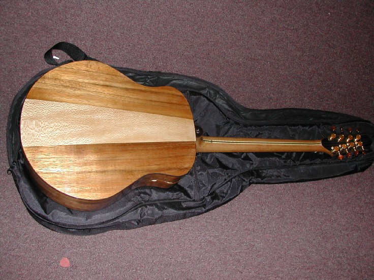

Here is a pic of a 3 piece back on the bouzouki I just finished. I had the same problem you had, some koa that was too small for the lower bout, and I only had a piece of Bob's sycamore laying around. Sorry Mario, I know this is what you are talking about not liking. But since this is my own personal instrument, I didn't mind. This was more like a prototype used with cheap woods. That Koa I found for $25, and the sycamore was about $2.
2 strips of cedar are over the 2 seams. Very simple to do, but it does require more precise cutting for the braces to keep straight.

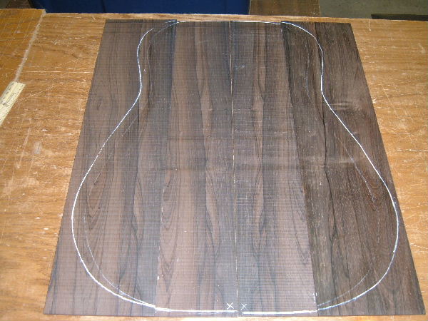

Here's a 4 piece BRW (old growth pre-ban) and it's MINE....all MINE....going on my new guitar commission this year.

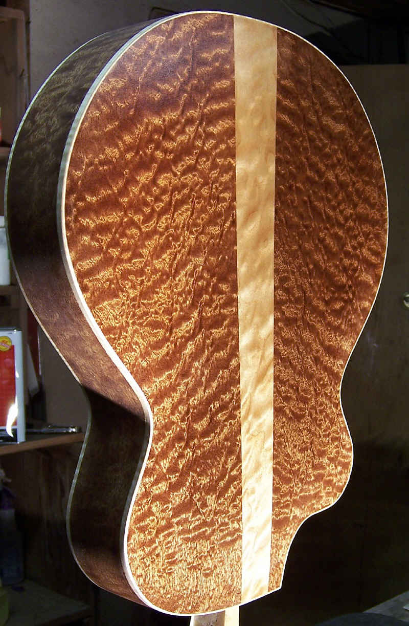

I love three peice backs! Heres one that i made, and I made the threepeice into a little 'theme' wich came back in the end graft.

Wow Lars, that is a great looking guitar. I love the way you you used the binding stripes to tie it all together. How about some pictures of the whole instrument. What is the top?

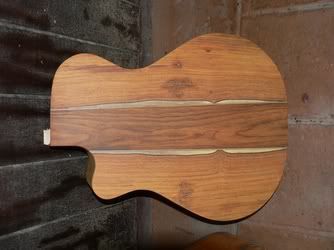

I think I posted this pic once before, but here's a nice looking 3 piece back with no bookmatches.
Here's a different take on a 3 piece...a little sapwood involved. Not sure I like it, but maybe someone will!

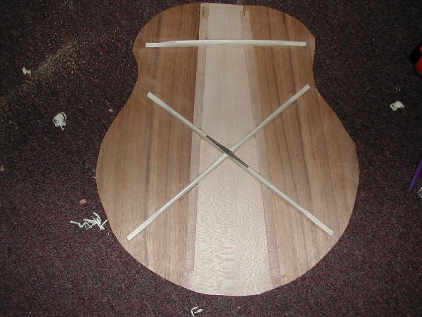

Heres the 4 piece walnut I'm working on right now. I had the same situation, but I had the wood on hand, so I used it. I don't have a picture with all the bracing on, but it takes quite a bit more fitting in between the back grafts.
I like the way it turned out though.

Thanks Jeff, i've posted this guitar earlier on this forum, heres the thread(which contains all the info about it);
http://www.luthiersforum.com/forum/forum_posts.asp?TID=6381& KW=lars+rasmussen#forumTop

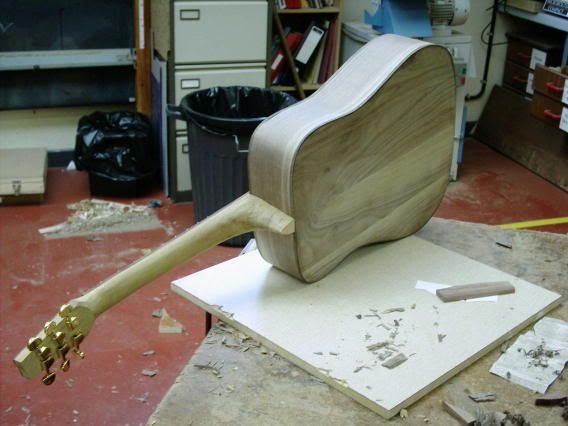

walnut you say......
this dred is being thrown together from off cuts from a shopfitter's dumpster......
4 piece back.
